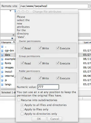

Are you using cPanel? If so, the File explorer should allow you to see them.
Also, if you are using FileZilla you should be able to see (and change) the permissions. You just highlight the directory and then bring up the option window (I think on Windows it's right click - on my Mac it's two fingers on tapping the touchpad).

phpMyAdmin is only for the SQL database related routines. If you have DreamWeaver (I believe it has built in FTP) then you can grab FileZilla (it's free - https://filezilla-project.org/download.php) and put your credentials in and log in via FTP (I use SFTP on my server, but I'm on a dedicated).
The ACP for XF doesn't have server directory file management abilities built into it.
