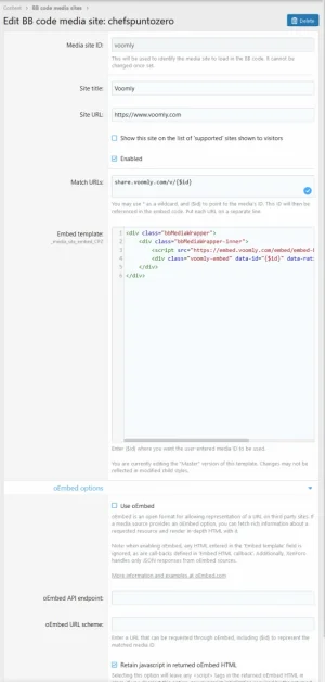

Here's my setup for the new BB code media site (advanced options not set) followed by the code text itself:
Match URLs: share.voomly.com/v/{$id}
Embed template: <div class="bbMediaWrapper">[I][/I] <div class="bbMediaWrapper-inner"> <script src="https://embed.voomly.com/embed/embed-build.js"></script> <div class="voomly-embed" data-id="{$id}" data-ratio="1.778" data-type="v"></div> </div> </div>
The strange thing is that the HTML code doesn't seem to be placed at all within the source page...

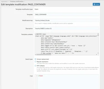

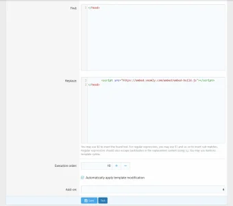

Remove the script code -- <script src="https://embed.voomly.com/embed/embed-build.js"></script> -- from the embed template and place it in the PAGE_CONTAINER template between the <head> </head> tags.

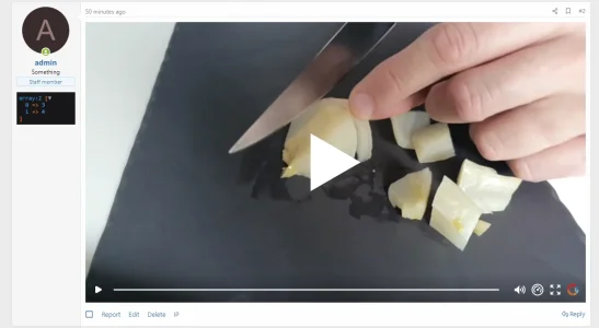

YEEEEEAHHHHH!!!! 🥳
It's working!

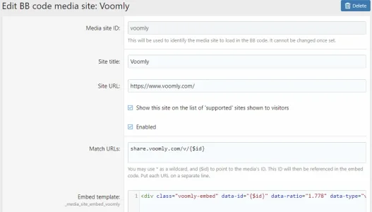

Don't actually know what happened, I was like 😠💭"Ok... Brogan did it!!! I must do it too!" 😁
So I started a delete+addNew+setup+test+delete+addNew+setup+test process for a couple of times, and it probably got stressed enough! :ROFLMAO:
On second attempt it just showed the empty space, but no video. After the third attempt it finally appeared!
:unsure: Might be because my board it's still private, you can't see content without logging in... Never mind! 😃 It works now!
