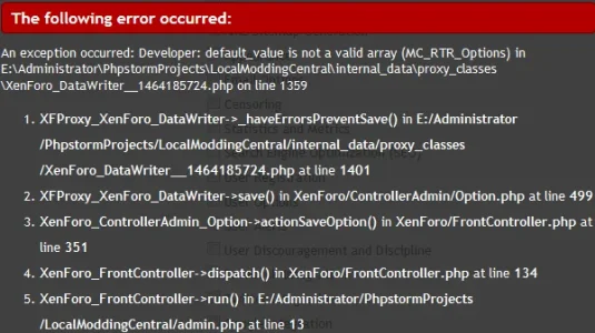

Once I click Save Option, I get this error:

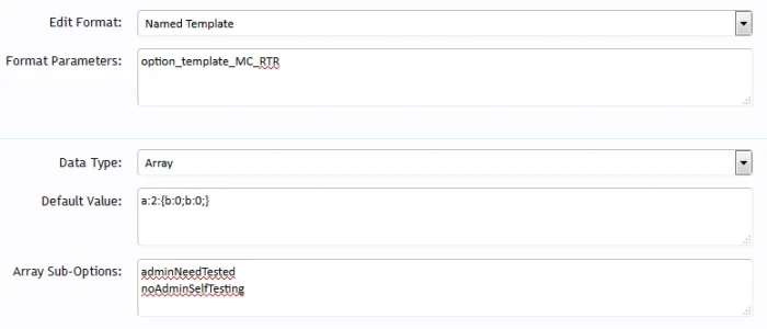

			I'm trying to make an option section with 2 checkboxes.
The first checkbox is the main one and the second one is an child of the first one.
I'm using:
- Edit Format: Named Template
 - Format Parameters: option_template_MC_RTR
 - Data Type: Array
 - Default Value: a:2:{b:0;b:0;}
 - Array Sub-Options: adminNeedTested, noAdminSelfTesting
