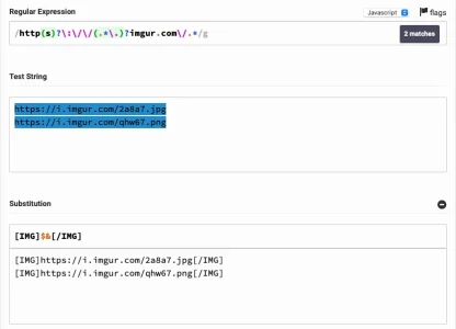

In case anyone every reads this in the future, i figured it out by myself:
Quick Find: https://i.imgur.com
Regular Expression: /https:\/\/i\.imgur\.com\/(.*?)\.(jpg)/i
Replacement String: [img]https://i.imgur.com/\1jpg[/img]
Change the .jpg/.png/.gif accordingly in both spots.
