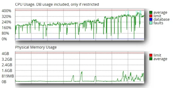

I have 4GB RAM with this hosting package but I don't think that's the issue. The issue seems to be processing power (please see the attached image):
