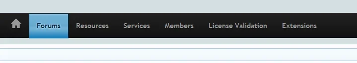

Not getting into this thread too much but try the following. you may need to add some !importants to it.
.navTabs .navTab.selected .navLink {
bottom: 12px;
height: 50px;
line-height: 48px;}
The output of that is as follows (below)

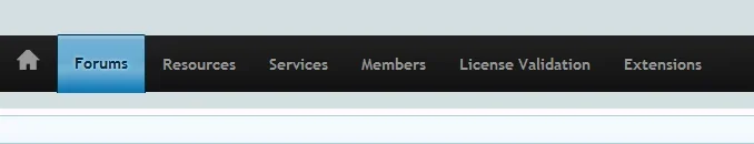

If you want it more flush at the top then add this css instead.
bottom: 14px;
height: 52px;
line-height: 50px;
The output of that css is as follows:
