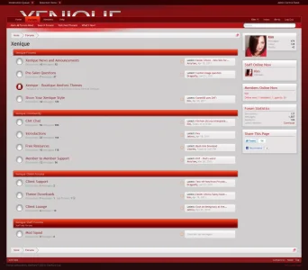

I have just completed a theme that was based off another theme, and was built as a child of that theme... on my localhost it looks like this...
However after export, and subsequent re-import it has lost a lot of the customisations, including some that were in the Style Properties of the Parent skin, and some that were directly altered within templates on the child skin...
Am I doing something wrong here?
