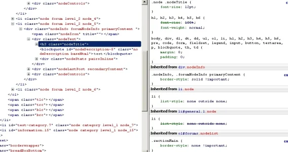

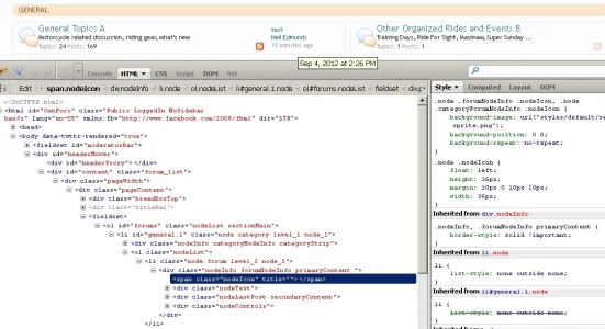

Goal: to change nodeIcon margins. A simple example that should be easy to follow.
Appearance>Styles>whateverstyle>Style Property Groups>Style Properties: Node Icons>Node Icon
Look at property margin, default value: 10px 0px 10px 10px
Change to: 9px 10px 9px 10px (can be done in SP, our task is to use EXTRA)
Inspect element with Firebug as per attached image.
The element we want is in class nodeIcon. Under the style tab it is listed as .node .nodeIcon
To style this icon in EXTRA I would refer to it as .forum_list .node .nodeIcon
This should select all nodeIcons in the forum list and apply the margin change to them.
code:
margin: 9px 10px 9px 10px !important;
And as usual: nothing happens!

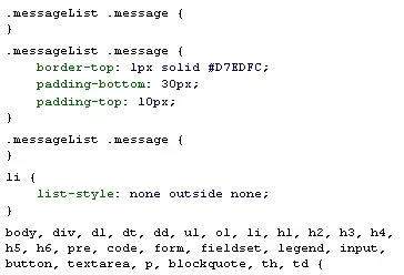

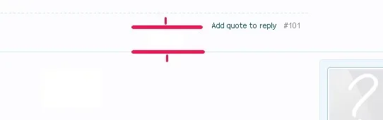

Continuing on with this craziness. I want to reduce the bottom padding on the message area. This is the space between the public controls and the top of the next message. I can adjust this fine using StyleProperties>Message Layout>Message Container. The default value is padding bottom 30px. I want to reduce it to 10px via EXTRA.
Here is my code in EXTRA.
.messageList .message
border-top: 1px solid d7edfc !important;
padding-top; 10px !important;
padding-right; 0px !important;
padding-bottom; 10px !important;
padding-left; 0px !important;
There is no change after applying this as you can see in the style properties (from Firebug).
I have to assume I'm calling up the wrong class. The server error logs are empty. Can anyone point me in the right direction?
.messageList .message {
    padding-bottom: 10px !important;
That should work just fine. You can see here >> http://d.pr/i/9Gf that the padding-bottom: 30px; gets overwritten just like it should.

Nice! Thank you, I looked at that many times and didn't catch it. Fixed!
And it was right in front of my face in post 11! [Smacks head on desk many times]
I'm glad these problems are MY fault, but it doesn't explain the weirdness of post 1.
Could that one colon error create the strange behaviour?
The code with the error would have to be above only the .forum_list .node .nodeIcon code if it caused the weirdness. I'm fairly certain this was not the case.
Thank you for looking at this. I tried the code exactly as you have it listed and wound up with no overwriting taking place. This is what really bugs me.
No problem, but don't get frustrated at Xenforo please :p, it's usually us that over look at things and we end up making minor errors such as small typos.
.nodeInfo, .forumNodeInfo primaryContent
border-top: 1px solid #d7edfc !important;
border-right: 1px solid #d7edfc !important;
border-bottom: 1px solid #d7edfc !important;
border-left: 1px solid #d7edfc !important;
border-radius: 10px 10px 10px 10px !important;
margin: 5px 5px 5px 5px !important;
/* ~adds border and margin to forum nodes~ */
primaryContent is a class and should have . before it (ie) .primaryContent
/* ~reduce bottom padding to bring up pageNavLinkGroup~ */
remove the semi colon(;) and add :
