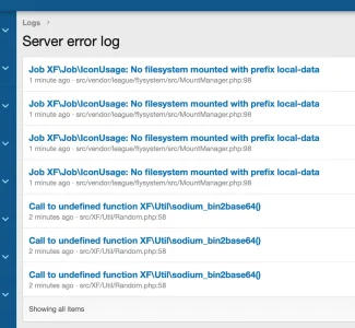

Hi: I've got a pretty basic site, with the Cloudflare and installation add-ons and that's about it.
When I upgraded, I immediately had a number of errors logs, as shown in the screenshot. I've closed the forum for now. Any idea why I got these errors, and if this can be easily addressed or should I start over, using the database backup?
The undefined function one is due to the sodium_bin2base64() function missing from PHP on the server (although the code seems to account for that so not sure why the error is being triggered.

Can you paste the full stack trace of the error related to the filesystem.
Brief update. I was one version down from the recommended PHP version and once I adjusted that and also uploaded the latest Cloudflare app version, I haven't had any further error messages so far. So hopefully those were the causes of both errors.
