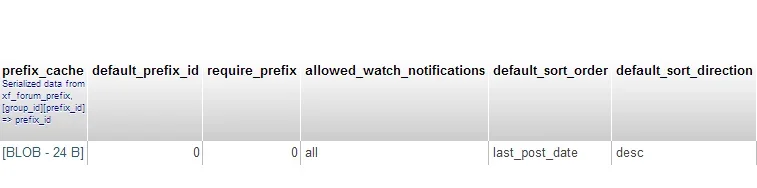

Well, I couldn't seem to find that column in the database so I checked against a fresh install and it seems I am missing the last 4 columns from xf_forum, starting with require_prefix. I tried to re-install by doing a "rebuild master data" but that didn't seem to help. Any suggestions on where to go from here?
Pic is from fresh install, not the install I am trying to fix.
It sounds as if that or another add-on has dropped those columns from the table.
I would recommend contacting the add-on author to see if that is the case.
You may need to restore from a back-up and wait for a fix.
