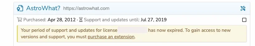

I just thought I would renew my support and get one year extension so that I can upgrade my forum and it might solve the issue.
When I purchased the one year extension and renewed my license and went to my site, it was working fine and started loading.
I can not believe XF would shutdown sites when the support expires, I thought its customers choice if they wanna renew the license or not, if they do not renew they have to live with the existing license and are not able to update the site with latest updates and will not get the ticket support.
But, I noticed, XF complete shutdown the site :(
Please tell me I am wrong? This is not fair if this is true :(
My site was dead from long time as the issue you can see in the original thread above, and I was looking for the solution but I thought I would upgrade my forum and it might help me. As soon I renewed my XF license, the next moment my site started loading fine without any errors. I have not upgraded yet my site but it started working right after renewing the license :(

It is most likely your host updated something on the server which broke your XF site.
If you were running an older version of XF and your host upgraded PHP to a much newer version, then it will have broken XF.
When you renewed and upgraded XF to the latest version, it will have been able to work on the newer PHP your host installed so might have seemed like and XF issue, but it wasn't. (y) :)
