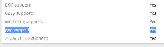

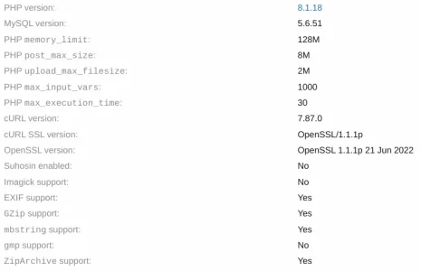

So I am still getting that error message. As soon as they turned on GMP, the site went down (500 error). You can see the configuration above. Nothing has changed. They turned off GMP again. What should I do?
