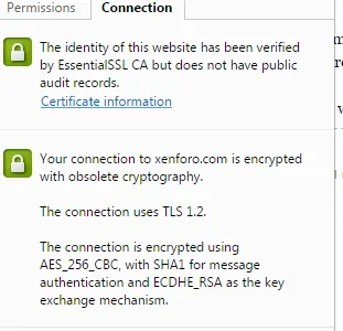

I just notice my site and xenforo in Chrome show this notification.
I read some article about that. It seems concerning about new encryption method, openssl version, and chiper suite. Too much to read for me :confused:
Anybody want to explain "what is that thing and how to fix that obsolete notification?"
I'm pretty sure it's for when sites are using SHA1 as opposed to a newer encryption method.
You should ask your SSL issuer to reissue your cert with a better method...

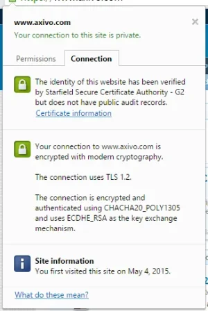

I presume you are using Nginx? Feel free to ask the question on our support site, Software forums. Expect to be challenged with logic, we do not spoon-feed our members. Instead, we want them to learn and actually understand what they are doing. Then, they understand the true essence of cryptography ciphers and adjust them on the fly.
You strongly recommend that based on what? The posted structure is chaotic and they list a bunch of useless ciphers which only expose you to future cipher-attacks. My list of ciphers is exactly 43 characters long. Please explain to other members here why we use only 5 ciphers.
https://www.ssllabs.com/ssltest/analyze.html?d=axivo.com&hideResults=on
Also, explain to us why the ciphers used on Centminmod site are not recommended, even if they show better results:
https://www.ssllabs.com/ssltest/analyze.html?d=community.centminmod.com&hideResults=on
