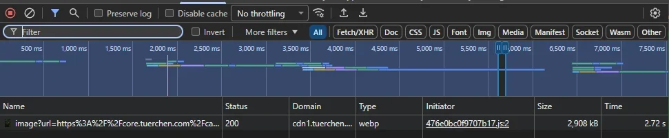

I took a quick look and it looks like that the CDN the calendar is loading from can be slow loading for the first view. On refreshes, it's a bit faster since some assets are cached in the browser. There's not much you can do when relying on a 3rd party to load the content. I'm seeing the content loaded as noted below: (2.72seconds from the CDN noted in the domain column)

Essentially, that calendar and its data is being loaded from a Content Delivery Network, which isn't served directly from your website. When a user loads that page, it calls the data from your site directly PLUS the added content from the CDN that is providing the calendar data to be shown to the client visiting your site. The speed of the CDN can be affected by the quality of the CDN, location of the local server that's actually serving the data. In the sample I showed above, it looks like I was being routed to Germany to get that data.
Thank you for explaining that. Yes the software company is from Germany. So they need to sort that as the old software didn't have this issue before they improved it! Maybe I'll just live with it! It's not that bad. Just slightly annoying. I've emailed them - maybe they can do something at their end?
