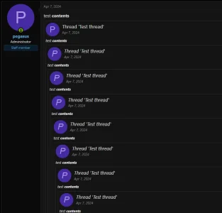

The most egregious example is:
1. Write a post with content.
2. Edit the post, adding an EMBED that refers to the same post.
3. The result:
There are other, less obvious variations of this, such as posts that refer to other posts in long circuitous chains.
3. The result:
