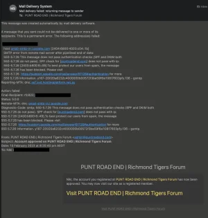

I've searched to find info on the multiple emails bouncing back daily filling my inbox. Below is a typical error, any thoughts on what needs to be done?

You need to configure your email settings correctly. It says (in your example) that SPF and DKIM don't pass because they are probably not configured. You'll also want to set a DMARC policy as well.
If you are using a 3rd party SMTP service, they should have some guides to help you set these up.

I have no idea what they are but will give it a go! Thanks for your advice.
