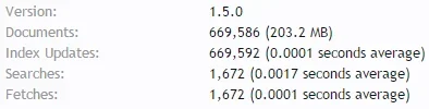

R rdn Well-known member Mar 29, 2015 #1 More info: https://www.elastic.co/downloads/elasticsearch Someone tried this with Latest XenForo and ES addon? Seems working fine on my live board Last edited: Mar 29, 2015

A Andy.N Well-known member Mar 29, 2015 #5 RoldanLT said: Seems working fine on my live board View attachment 102545 Click to expand... what process you used to update? Upvote 0 Downvote
R rdn Well-known member Mar 29, 2015 #6 Andy.N said: what process you used to update? Click to expand... https://community.centminmod.com/th...-original-elasticsearch-repo.2450/#post-11443 Then just use this repo: http://www.elastic.co/guide/en/elasticsearch/reference/current/setup-repositories.html Instead of 1.4 Upvote 0 Downvote
