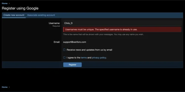

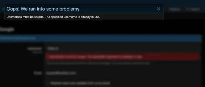

Do you not see the "Usernames must be unique" banner immediately after typing a duplicate username?
This is the behaviour I see, and the expected behaviour:
I feel like there's something missing here so if you can elaborate that would be appreciated.
Yes, I see it. If the name already belongs to an older account, the form rejects it fine.
