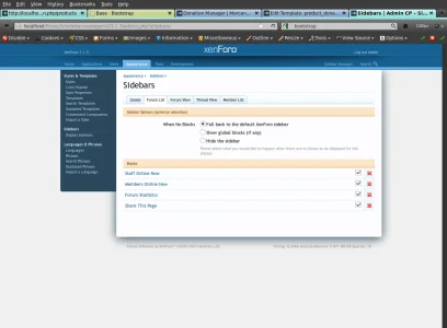

The whole idea of it is meant as a sort of "add-on" to my existing products as I get lots of requests to move blocks around or support the widget framework or something. It is much easier in the long run to just make my own system which is more developer friendly so I can easily manage it.
And it does have more features... I have global blocks (blocks that show up in every sidebar), user criteria per block, blocks get set to multiple sidebars, options per sidebar. It's all very simple from the outside and nice and easy for developers. I will give one screenshot WIP.
