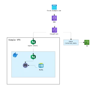

I'm running xenforo in a docker environment launched via docker-compose, I also use S3 to store the files (internal_data and data) and Cloudfront as reverse proxy for S3 and also to a simple VPS :
My dockerized env is very basic : Nginx + PHP + MySQL + Redis

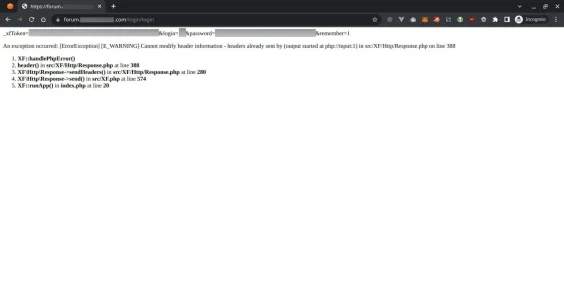

Everything works fine but after a few hours errors start appearing : I can no longer connect to ACP or my XF forum (I have to try again several times).
Here is the stack trace :
An exception occurred: [ErrorException] [E_WARNING] Cannot modify header information - headers already sent by (output started at php://input:1) in src/XF/Http/Response.php on line 388
    XF::handlePhpError()
    header() in src/XF/Http/Response.php at line 388
    XF\Http\Response->sendHeaders() in src/XF/Http/Response.php at line 280
    XF\Http\Response->send() in src/XF.php at line 574
    XF::runApp() in index.php at line 20
If I restart my docker container (PHP image), the bug disappears
I wonder what could be the cause of this error, any idea ?

Random question, do you run NGINX, PHP-FPM and MySQL in 1 container or spread across multiple containers?
Hi, it was spread across multiple containers (y)
I just realized that my diagram can be a bit confusing ^^
4 services (now 2 because I just use dockerized MySQL + Redis) launched via docker compose
