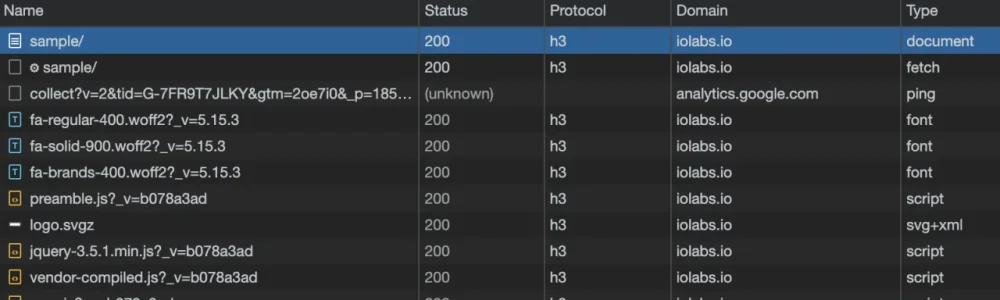

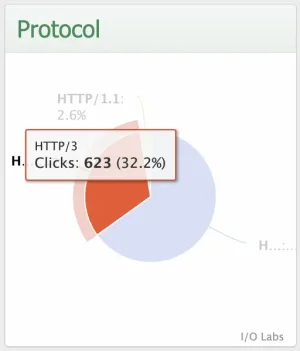

Honestly, I don't know enough about how certain government block Internet traffic to be of much help. But yes, HTTP/3 itself is built upon UDP rather than TCP. I have a click analytics system that makes a chart of the HTTP protocol that end users are using here: https://iolabs.io/analytics/sample/
Most users are using HTTP/2 (65%) and 32% are using HTTP/3, so I guess 32% of those users are using UDP as the underlying transport. For me personally, when I go to that sample page and check the HTTP protocol being used by my web browser, it is indeed HTTP/3:
So from the looks of it, Cloudflare is working fine/as expected with UDP (as long as you have HTTP/3 enabled for your zone under the network settings) since I'm pretty sure that HTTP/3 only works with UDP.

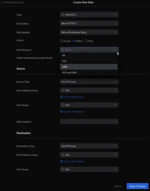

Uh what? No, that's wrong. You most definitely can block UDP traffic just like you can block TCP traffic. UDP isn't some magic protocol where network hardware is forced to route it if it doesn't want to. You can block it all or you can block specific port(s). Someone could block all UDP traffic except for port 53 (DNS) if they wanted.
I just double checked the router I use, and you definitely can choose to create firewall rules based on UDP and/or TCP (see the UDP drop-down on the Protocol line)?
So you could probably block HTTP/3 on your network simply by blocking UDP port 80 and 443.

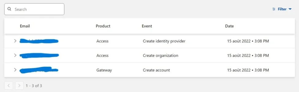

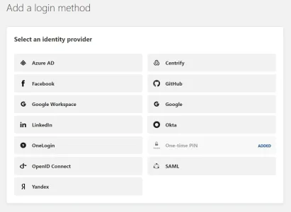

Hello, i just installed this add-on and i try to create Access policies : when i click on th create button a warning/information message appears, then i click to the button in the overlay and i'm back to the page, there is no way to create a policy, what i am missing ?
On CF Dashboard i enable the ACCESS system. (Zero Trust now correct ?)
Thanks.
digitalpoint
Any errors or anything in your XF server logs?
I just tested it by deleting the Access rules I have and then letting the add-on recreate them and it created them as expected. One possibility would be to go to Cloudflare Zero Trust -> Settings -> Authentication and make sure you have a Login method defined. The add-on is supposed to check that, but maybe Cloudflare changed how you check that? Not quite as easy to test on my end because deleting the login method causes some problems for existing users.
digitalpoint
The only thing I can think of is if it's an API permission issue (although it's supposed to throw an exception you can see if that's the case). I've messed with various API permissions trying to replicate what you are seeing (no error and no action), but I haven't been able to do it. If I take away the Access permission (or make it read-only), it kicks back the expected permission error.

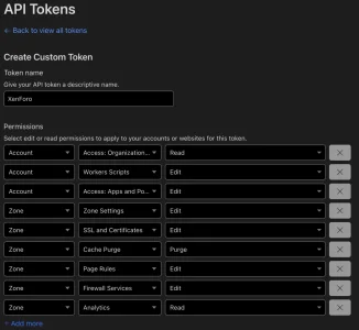

That being said, it probably wouldn't hurt to make sure your API permissions are set correctly. This is what you should have:
Make sure you have the right Account Resources, Zone Resources, check if you are IP filtering API calls as well as the TTL on the API token.
For me, I have Account Resources set to include All accounts and Zone Resources to be All Zones (then you can use the same API token across multiple sites).
Also make sure you have the Access: Apps and Policies set at the Account level, not the Zone level (it's a different API call then).

Any chance you could switch to API token in your settings in XF Admin -> Options -> External service providers?
While it should in theory work with a Global API key, it's not recommended to use a Global API key (huge security issue because that API key can be used for any/all things in your Cloudflare account across all zones... could do some serious damage if that got stolen).
Maybe the Global API key doesn't work as expected with Access stuff? Worth a test anyway... and like I said, I'd really recommend NOT using Global API keys anyway.

I can of course, but i really don't know how to.
I'm on the right page in CF but i can' fill fields by myself to create a token.
Authorisation : ??
Ressources : ??
IP Filter : I suppose i can leave blank here ?
TTL : ??
