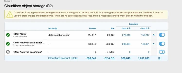

While I was digging into the guts of XenForo to fix that issue, I realized that XenForo treats media differently than other files. Specifically video and audio files go straight into data fully rather than internal_data. Which solves the issue where XenForo is fully processing those file types when someone wants to download them. I think the problem for you is that it's only video and audio files that do that... so if you had massive attachments (like a disk image), those are still going to go through the normal attachment system where XenForo is processing the underlying file every time someone wants to download it.
If you end up building something custom to handle it (which probably is going to need to happen to get around all the issues you are going to run into), this is how I'd do it...
  • Leverage XenForo's ability to treat certain files different (do what XenForo is doing for media for other extensions like disk images)
  • Bypass XenForo's normal uploader and use R2 presigned URLs. Cloudflare is working on an example of how to do it exactly (see here) for those that don't know how to code it.
  • Probably schedule cron job a certain number of hours in the future in XenForo to clean up situations where you generate presigned URLs that a user can upload to, but they don't actually do it (then you don't end up with a bunch of "empty" attachments).
That allows you to not be limited to the constraints of XenForo's upload system and also allows you to get around the 100 second thing since the underlying http request isn't going to your server.
I've just swapped another site fully over to this, and the two buckets exist, and the attachments folder in present in the specific bucket.
Getting the following error when uploading attachments now:
League\Flysystem\FileNotFoundException: File not found at path: attachments/232/232281-d410e70db19b8a9699626ab0b7cc502e.data in src/addons/DigitalPoint/Cloudflare/League/Flysystem/Adapter/R2.php at line 166

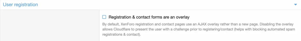

By the way, with this option unchecked:
The login menu is still displayed as an overlay.
Honestly the function to force a challenge to those pages to help mitigate spammers isn’t really the best option anymore. Cloudflare’s Turnstile captcha effectively does exactly that and it works in an AJAX request so can be used in an overlay.

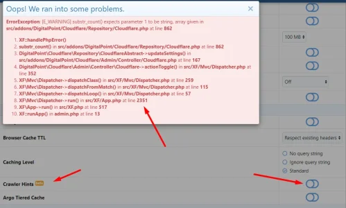

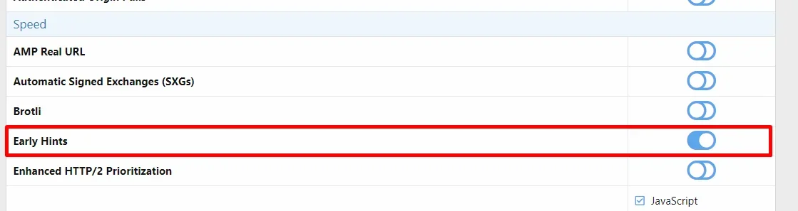

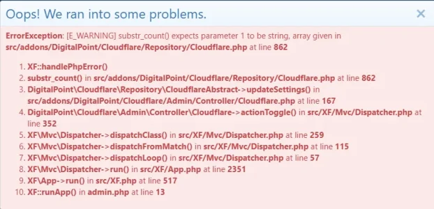

Hi get this Error log
as tried to diable the Early Hints opion
also get the same issue with some other otptions if I try to disbale them. For example:
If you reload the page and try changing Early Hints first is it an issue? I was able to replicate it on Crawler Hints but not Early Hints so far.
