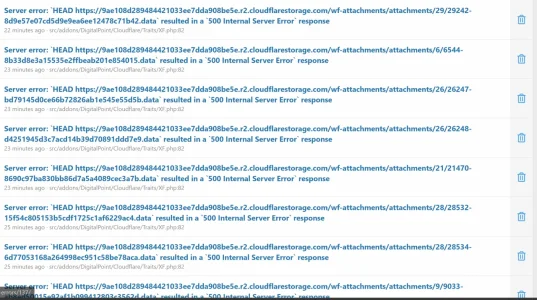

Is anyone else getting 500 internal server errors from Cloudflare R2 within the last 40-90 minutes since the latest update? Hmm
I'm not (checked multiple sites). Do you have a backtrace from the XenForo error log by chance?
A 5xx error is a server error that by definition can't be fixed by the client though (things like malformed syntax, permission issues and that like are 4xx errors, which can be fixed). But a backtrace should show if the error is actually on R2's side or not.
Sorry to just dump this on you, I have a call in less than 30 mins. I wonder if its because I turned guest page cache'ing back on, but no idea right now. Could just be an issue with on their end temporarily. I don't see anything for the latest 20 mins so not sure if its stopped.
If you click on one of those you should be able to see the URL that someone was at to trigger it. If you visit one of those URLs, are you able to generate a new error or are things back to normal/working as expected?
Might be the same issue someone saw yesterday that cleared itself up: https://xenforo.com/community/threads/digitalpoint-app-for-cloudflare®.206176/post-1611157
But ya that's definitely a 5xx error coming from a Cloudflare server. I suspect it will work itself on it's own if it hasn't already, because like I said... a 5xx error means there's nothing different we can do on our side but the server is having an issue. 4xx errors are the ones we are able to change something to change the outcome.
