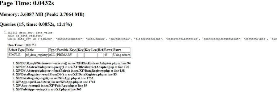

Now when you enable debug mode from the src/config.php file and you click on the page render time, you get something like this:

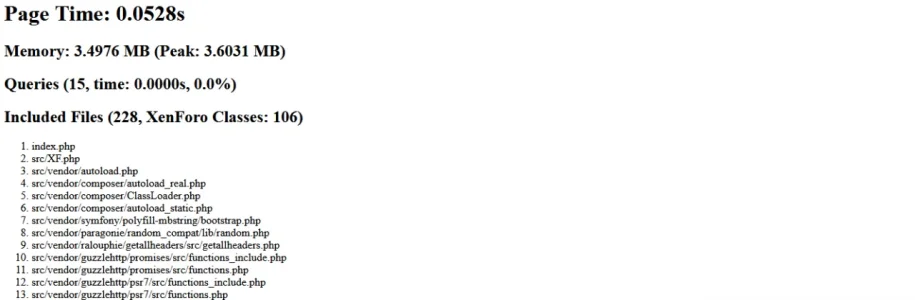

When you enable debug mode with my addon you get this.

Yes :)
The DB connection is already established if you enable debug mode via an Add-on and logQueries will not have been enabled.
PHP:
$container['db'] = function ($c)
    $config = $c['config'];
    $dbConfig = $config['db'];
    $adapterClass = $dbConfig['adapterClass'];
    unset($dbConfig['adapterClass']);
    /** @var \XF\Db\AbstractAdapter $db */
    $db = new $adapterClass($dbConfig, $config['fullUnicode']);
    if (\XF::$debugMode)
        $db->logQueries(true);
    return $db
You can enable it manually, but the output will still be a bit different as it will not be enabled for queries executed prior to visitor_setup.
The database adapter is being initialized before \XF::$debugMode is set to true, so it never hits the conditional to log queries. I would probably recommend using app_setup instead of visitor_setup to hook as early as possible, but in either case you'd likely have to enable logging manually since you're fetching the visitor object before enabling it:
PHP:
\XF::db()->logQueries(true);
Edit: It looks like you probably can't fetch the visitor yet from app_setup, so visitor_setup it is.
PHP:
This worked perfectly, \XF::db()->logQueries(true);
