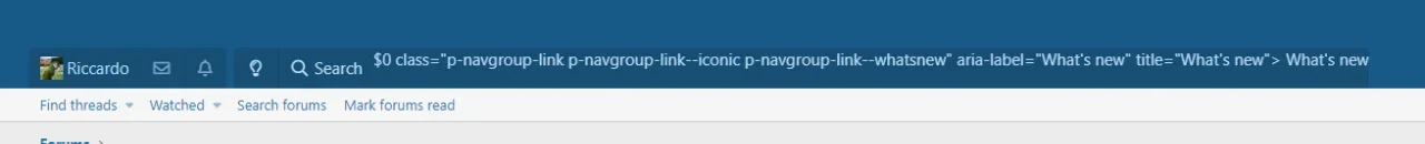

in PAGE_CONTAINER I can not find <a href="{{ link('whats-new') }}"
Line 287
                        class="p-navgroup-link p-navgroup-link--iconic p-navgroup-link--whatsnew"
                        aria-label="{{ phrase('whats_new')|for_attr }}"
                        title="{{ phrase('whats_new')|for_attr }}">
                        <i aria-hidden="true"></i>
                        <span class="p-navgroup-linkText">{{ phrase('whats_new') }}</span>
                    </a>
Questo codice non funziona
HTML:
<xf:if is="$xf.visitor.canChangeStyle()">
    <xf:set var="$light_style" value="YOUR_LIGHT_STYLE_ID" />
    <xf:set var="$dark_style" value="YOUR_DARK_STYLE_ID" />
    <xf:if is="$xf.style.style_id == $light_style">
        <xf:set var="$new_mode" value="{$dark_style}" />
    <xf:else/>
        <xf:set var="$new_mode" value="{$light_style}" />
    </xf:if>
    <a href="{{ link('misc/style', null, {
        'style_id': $nuova_modalità,
        '_xfRedirect': $reindirizzamento,
        't': csrf_token()
    class="p-navgroup-link p-navgroup-link--iconico p-navgroup-link--styleswitcher }}"
    title="{{phrase('style_chooser')|for_attr }}"
    aria-label="{{ frase('style_chooser')|for_attr }}"
    aria-expanded="falso"
    aria-haspopup="true">
        <iaria-hidden="true"></i>
        <span class="p-navgroup-linkText"></span>
    </a>
</xf:if>
$0[/CODICE][ATTACH type="full"]289211[/ATTACH]
Are you using the default style? Most template modifications are based on this. I used this in a themehouse style and need to figure this out myself.
I found that piece but if I replace it with the code it gives me that error that you see in the scree.
