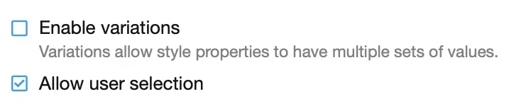

1.) when I enable variations to enable dark mode...
... my header graphic is not displayed any more, neither in bright nor in dark mode. Instead there is a broken image. When I check the URL for the logo it looks like this:
if I switch off variations the URL looks like that...
and works like a charm (as it has always done). The logo is there and should work - but for some unknown reason the URL does not get rendered correctly when turning on variations.
https://myforumurl/var(--xf-publicLogoUrl)
https://myforumurl/data/assets/logo/logo-small_192.png
