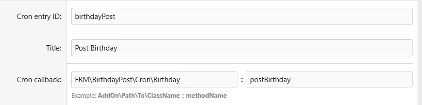

So, I've tried adding it as a manual cron in the ACP linking it to the add on.
And it just stays on the same page with the loading bar with this in the console:
