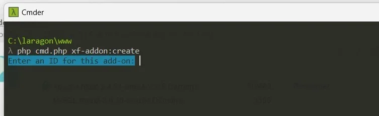

Where would I run this command line ?
Did you install a local XF for dev purpose ?
I highly recommend Laragon to install a local XF, it's super simple!, then you can use Terminal directly from the software.
