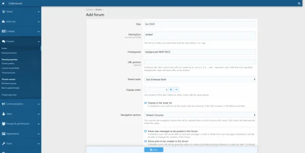

I tried to add a new field to "nodes" in the admin interface, so that I can write something into a text box and use it as a variable for each category/forum. Screenshot-2018-4-8 Add forum Craftonia net - Admin control panel.webp
Adding a new field wasn't that hard. I simply created a macro for the new field "background" in the "node_edit_macros" template

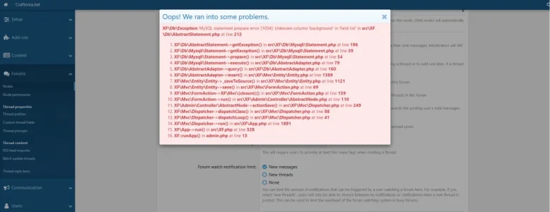

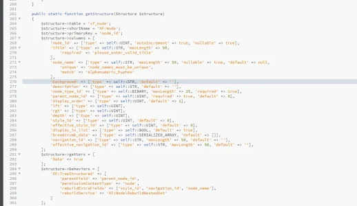

. So the first step was taken. Now an error message Fehlermeldung.webp appeared, which I could fix by adding a "background" function dad.webp into the "Node.php" which is in the path /src/XF/Entity/.
Everything now looks as if it could work, but the text I enter in the field does not save itself. This is also relatively logical, since no new entry has been created in the database. After several tests, this error message appeared: daaa.webp
I think the problem seems to be that no new field was created in the database....

mm yes I've created the row in xf_node table and if i add some text via the database the text get's displayed in the field in the xenforo interface... The Problem is that I can't save something in the Interface so if I wrote something in the field and hit the save button the text doesn't get saved...
If I remove the default => '' from my Node.php from 'background' => ['type' => self::STR, 'default' => ''] to 'background' => ['type' => self::STR]
I'm getting a error code that the default value is not defined:
XF\Db\Exception: MySQL query error [1364]: Field 'background' doesn't have a default value in src\XF\Db\AbstractStatement.php at line 212
