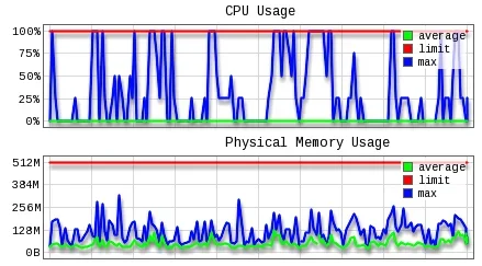

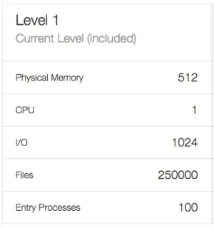

My current shared hosting plan:
Last 24 hours

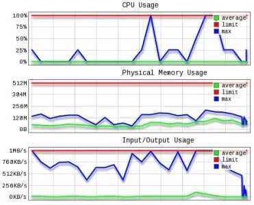

Last 7 days (The Input/Output is not rendering because the cpanel is not fully loading either)

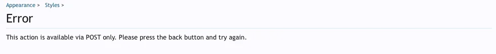

I'm still having issues on the back end. Every time I go to change the header image back to what it was earlier the page times out and when I refresh I get the message below. I have even tried reset.

I agree but I'm trying figure out if this is a host issue of a bug. This came out of nowhere. I disabled all the add-ons and reverted back to the default style and I'm still getting the error when trying to change the header image.
screen-shot-2014-12-04-at-3-34-47-am-png.91003
