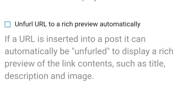

I might be wrong, but I think you don't need to do anything for urls in a post to unfurl, except to set an option in acp to unfurls urls.

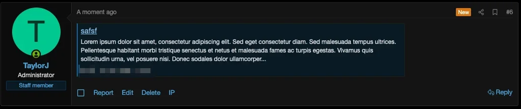

I had a typo in my prepare method call, pointing this out made me go back to look and I noticed the typo right away so now at least they are working in blog posts.

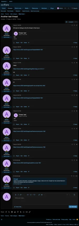

I hardly can see anything on a picture you posted )
Did you check metadata with some tool? Maybe a typo, too?
Pretty sure metadata is setup properly on my blogs/blog posts but also not sure that has anything to do with a url getting unfurled properly.

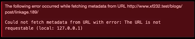

Content unfurling was actually working the entire time just not on my local install...
But I do have to somehow get it styled and used in the same way if it's local content being unfurled.
