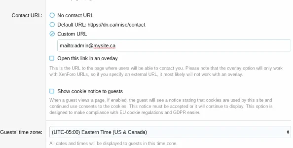

PS,: I stopped the spam 100% my using a custom contact form URL and simply inserting the board email address.
Never had a spam email from them since because their spam bots are looking for a form.
