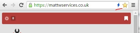

I used http://spdycheck.org/ and it said SPDY was enabled.

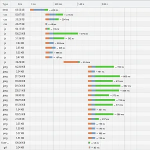

Using http:
Firefox
Chrome

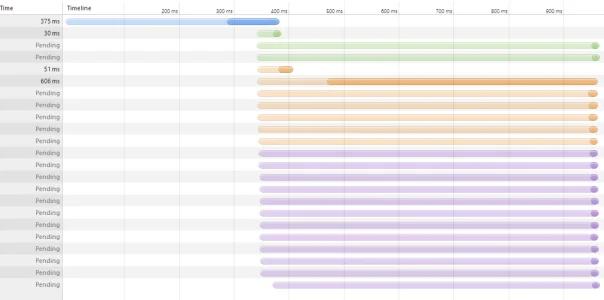

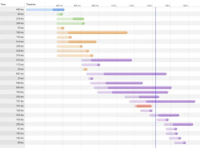

Using https
Chrome
So i'm not sure what's causing all those requests to wait/pending when accessing from SSL. Also this usually happens if I do a hard refresh on the browser. This doesn't happen if I downgrade to version 4 series, but that means no SPDY feature.
