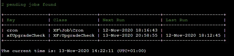

Note that after installing the latest version, if you are seeing the message "There are scheduled jobs outstanding which have not run. Jobs may not be getting triggered when expected."
... check to see whether you are still using the --time command line option.
This option has been renamed to --max-execution-time to match the option names used in the core job runner.
Make sure you have updated all of your cron tasks to use --max-execution-time

hi, thanks for the plugin, great job. I have a problem with one forum tho, the usual error:
Weird thing is that executing command manually (without any parameter), it says all jobs have been executed, but a second after i do hg:show-jobs and i get this:
It seems it isn't registering cron last run, i have it set to run every minute (without params either). Any idea on how to fix that?
Regards,
That's strange - it is indicating that the Cron task has never been run.
Look in your xf_job table - there should be an entry for "cron" with the last_run_date column set - if it is blank, then your XF crons aren't running.
Temporarily turn off your unix cron task and then run hg:run-jobs -vvv to show full debug output and either post here or message me with the log output.
What version of XF are you running? Which version of the addon?
