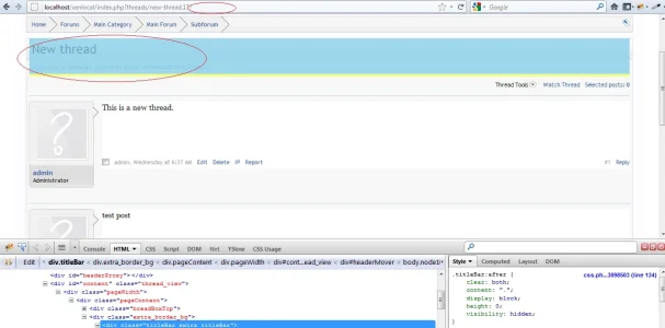

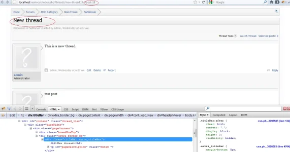

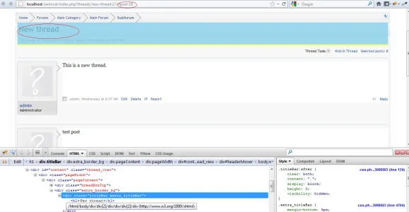

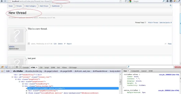

The CSS problem is when the url contains "#post-xxx", the titleBar block/div is moved up 10px and and pass the top border of the "extra_border_bg" container/div top border that is around the whole thing between the upper and lower navbars.
See the images:
This doesn't happen in any page, only on thread page when the current page link contains "#post-xxx"

I noticed there is no issue when the page first load, once it jumped to the "#post-xxx", it moved up. :confused:
