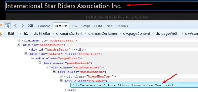

How would I go about changing the title in the title bar? I've changed it in Basic Board Information but that hasn't changed anything View attachment 132435
Not in this case I don't think, there is nothing I can find in phrases that has to do with the board title. If I change the board title it should change in forum page but it doesn't, it stays the same in the div class titlebar
If updating the Board Title doesn't change it then that would suggest one of three things: an outdated template, an edited template, or a template modification which is overriding it.
The very first line in the forum_list template shows where it is pulled from:
@Brogan Thanks, I'll have a look, the forum_list in default shows some green patches which I assume are edits or modifications? Nothing about boardTitle had been changed though.
