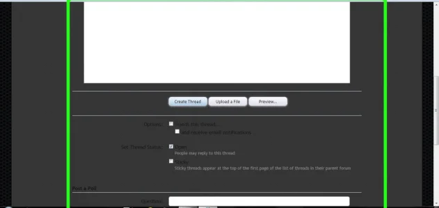

Another theme support thread :D I need to know how to change the color of the area surrounding the NewThread options (See picture for details. The whole area surround in green down to the submit button) I don’t like it having the same background as everything else :p It blends into much It needs to stand out and I plan on making it a light blue color. Can anyone help me?

That actually uses the #content .pageContent class so I'm not sure you can do a lot with it, without affecting everything else which uses that class.
If you update the background colour in Style Properties -> General -> Content, you will see what is affected.

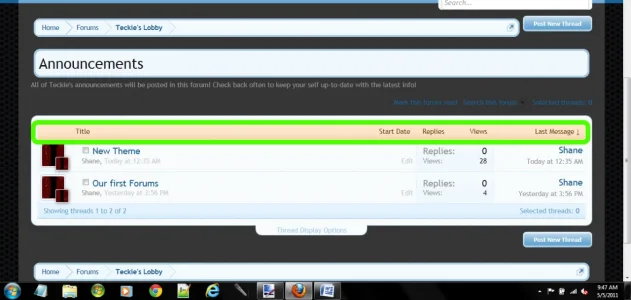

That is to bad... I have a new question how to you change the color of the upper tab that controls what messages are first. Highlighted area in green...

.discussionList .sectionHeaders is the CSS for that - Building Blocks -> Sub-Heading in Style Properties.
