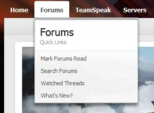

Need some help with this one please.
When I hover my mouse on the forum tab it turns white, when you hover over and the forum quick links show, like mark forums read and so on.
The problem is that it that the forum tab stays white when I click other pages in the nav menu. Other the other tabs have a clear back ground and stay clear when clicking other tabs in the nav menu.
So any ideas on how I can just keep the tab with a clear back ground. I dont need any back ground colors for the tabs.
Any color when the mouse is hovering over a tab is ok. I just need to remove any color in the tab once its clicked or when I click another tab.
Sorry its kind hard for me to explain. My forums are at www.europeclan.com if you want to have a look.

The other pages are considered Nodes, therefore when you click on them technically it's part of forum.
Have you tried out http://xenforo.com/community/resources/nodes-as-tabs.9/
It fixes that problem, it appears you're possibly doing manual template edits?
Nodes As Tabs will let you "promote" your pages to the nav tab.
Such as mine:
http://gamerexit.com/pages/dayz-server/
The Servers is highlighted, even though it's a page node.
Ok, I've got it sorted. I had to uninstall the navigation manager 1.0 add on that I had, then just use what you posted Russ.
Thanks allot!
