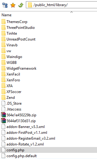

I struggled with this, so here is what i did.
Similar what teh guys mentioned above, open your config file
edit it
I added the lines for it below my databse details
Magic.

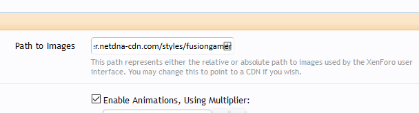

Then go to appearance, style properties, general, then look for path to images
insert your CDN url
Mine being http://www.gunchester.gunchester.netdna-cdn.com in front of your /styles/themename
