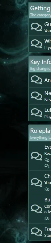

In the images below, your forum is on the left and mine is on the right. I would like to turn individual icons on my website into different icons akin to how you have it on your forum. I found some code: https://xenforo.com/community/threads/changing-picture-on-categories-from-speech-bubbles.186634/ In this thread, but I cannot get it to work with different icons for different categories.
It says something about Node Id's but I cannot find those in the node list.
The icons are automatically applied based on the node type.
The Announcements icon is an article forum.
Frequently asked questions is a link (to a thread).
Pre-sales questions is a question forum type.
Suggestions is a suggestion forum type.
The forum types are set per node in the node settings.
Or do you want to use completely custom icons for each node?

Alright, thank you. That helps a little bit.
I think I used a bad example. I indeed want completely custom icons for each node.
Though, a way to remove them altogether would be amenable as well.
