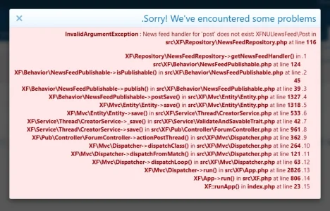

the below issue with the localhost server, after restore data i can not add any new post, also i can not replay?

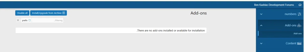

i already delete all add-on
One of the biggest problems with XenForo is these plugins that plant tables in the database and fields in other tables, and when you delete them, they don't delete the fields planted in those tables. You need an expert to delete those fields from the database.
Developers should find a solution to this problem in the future.
If any do not delete I would report to xenForo as it would appear to be a breach of minimum standards 11.4
  • Any new tables or columns added must be removed on uninstall.
