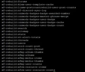

Do it via CLI and you don't need to monitor.
You can use screen to maintain the shell session even if the connection is lost.
I just quickly checked the code and it doesn't seem like there is one for rebuilding attachment thumbnails.
So it will have to be done via the ACP/browser.
You should be able to modify the code to target a specific range or even individual attachments.
