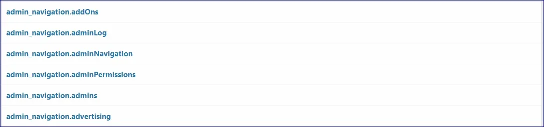

I wouldn't recommend that, as it can't be translated (unless that's not a concern for you). You could use phrase groups for this purpose though: my_addon_fields.{$column}
Sorry, but what do you mean by phrase group? Can we define something like that in XF phrase system? Or you meant to pass an array like my_addon_fields = ["total_cost" => "Total Cost"] from PHP controller class?
