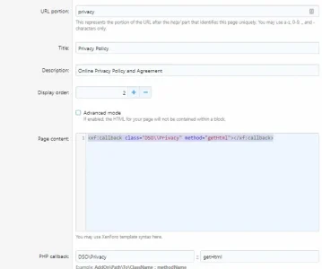

I'm trying to use it on a Help page. Do I need to add an extend Help?
I changed the Page content to the below, but I still don't get output on the page.
HTML:
<xf:set var="$privacyHtml">
    <xf:callback class="DSO\\Privacy" method="getHtml"></xf:callback>
</xf:set>
{$privacyHtml|raw}

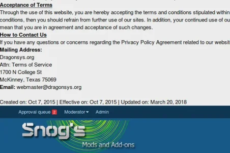

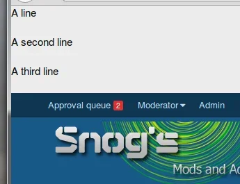

I tested your code on my development server and it works fine with just the callback. This is with the callback inserted into the page container body before the first DIV.
All you need is this in your template...
<xf:callback class="DSO\Privacy" method="getHtml"></xf:callback>
But the text does need to be HTML formatted.
