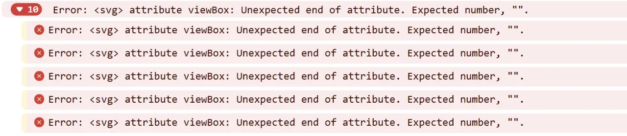

You have a lot of error console concerning svg files too

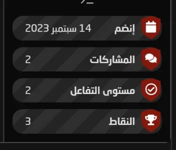

From the postbit i think

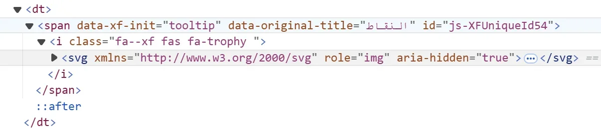

HTML:
<dt>
    <span data-xf-init="tooltip" title="مستوى التفاعل" >
        <i class="fa--xf fas fa-circle-check "><svg xmlns="http://www.w3.org/2000/svg" viewBox="" role="img" aria-hidden="true" ></svg></i>
    </span>
</dt>
The Font Awesome syntax used here is outdated, please check this post: https://xenforo.com/community/posts/1648280/
And i don't know if mixing FA icons and SVG file is correct, so check this too.
HTML:
<dt>
    </span>
</dt>
