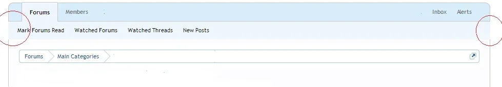

Hello guys, I am not able to get border to show up on the 'selected sub tab' navigation bar as indicated by the red markers in the attached image. Not sure what I am doing wrong. Is there a way to get these areas to have a border through the extra.css? Thank you.

.navTabs .navTab.selected .tabLinks
    border-left: 1px solid red !important;
    box-sizing: border-box; /* fixes funky overflow */
Adding that to EXTRA.css should work.
