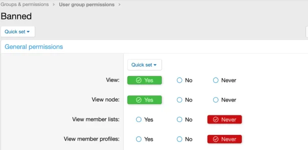

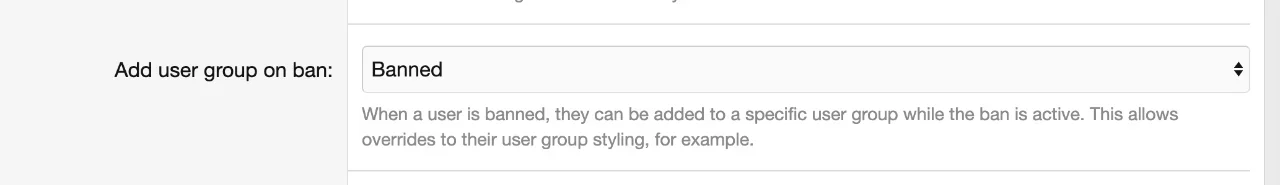

I think you can. If you set banned users to a new usergroup "Banned" and set the permissions correctly.
admin.php?options/groups/discourager/
Then set permissions admin.php?permissions/user-groups/banned.5/
Have you moved the banned users to the banned group?

Thanks, it's working halfway now. The user can't be blocked; I have to manually add them as an admin to the "Blocked Users" group.
But what good does that do me if a moderator wants to block a user for 7 days and provides a reason? The user can't see the reason for the ban.
Then I have to manually unblock the blocked user after 7 days. That's not the best solution either.
As mentioned upthread use the Warnings system (/admin.php?warnings/)
To do a "ban" as a warning - create the warning, points don't really matter. Set a sensible expiry if your "bans" are a typical length or "never" if they are permanent. Leave the editable box ticked if you want your mods to be able to set the "ban" duration. Then tick the box for your "ban group in the extra user groups section, tweak the message as required. Save. Now your mods can issue this warning and set the expiry for however long the ban should last for.
