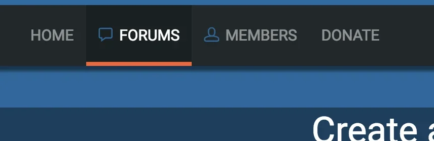

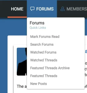

What about this, I'm using the code I previously posted to disable the sublinks, which is great when your on /forums but I'm using Featured Threads from Brogan as well, so when your on the homepage it doesn't seem to function and the "forums" link becomes a drop down again. Any idea how I could at least get that to function on the featured threads homepage like it does on the /forum page?
First pic is what happens on the featured threads page, second is on the /forum page.
Example: www.skepticalgeneration.com
The simple way is to just yeah edit the navigation template. But if you want to create a ticket at themehouse.com I'll take a look and see what I can do!
