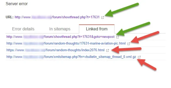

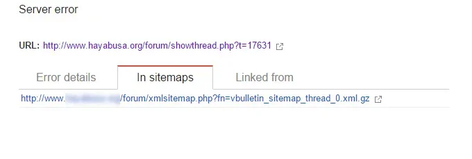

Well in my limited knowledge I fixed one of the issues (Go me) but the others I am going to have to get someone to help... I have a lot of history on the site (about 17 years now) and a lot of other forums going back to ikonboard... My problem in front of me now is that Google Webmaster is starting to complain about it.. They are sending me bot emails :)
I can see the gallery from Vbgallery is an issue and also attachments, a couple of examples..
What google is showing
/gallery/showimage.php?i=1699&catid=newimages
What google is showing - If I click on the link it downloads the file to my computer! So this has to be something else... I just checked and they all seem to be quicktime movies that have been posted over time, weird.
/forum/attachment.php?attachmentid=176649&d=1266019552
Redirecting attachment.php is handled by these redirect scripts:
https://xenforo.com/community/resources/vbulletin-4-x-url-redirection.120/
That is something else. Can you provide both the old and new URL for that specific page? Specifically I want to know if the ids are the same in which case a rewriterule will suffice.
